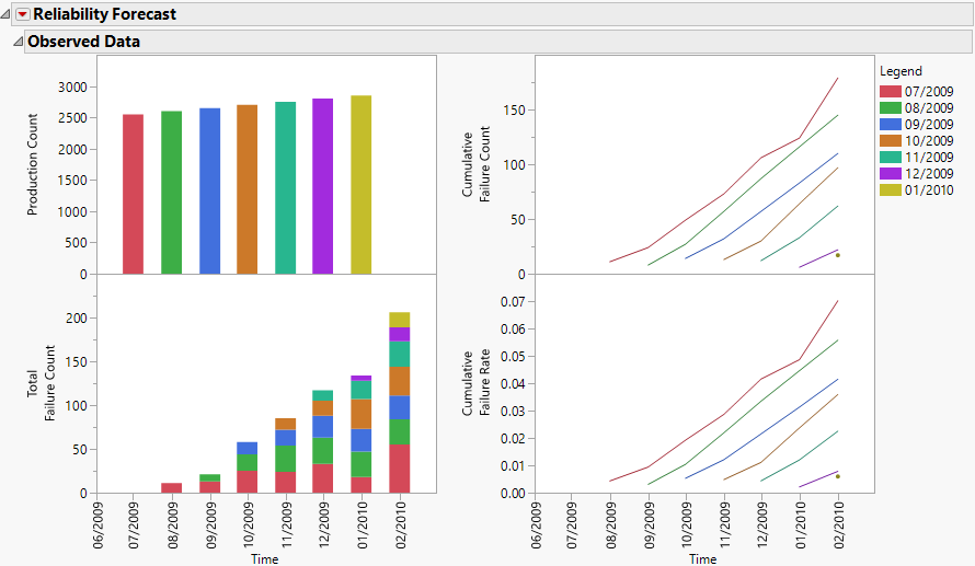

Figure 9.2 Observed Data Report
In the Observed Data report, the bottom left shows bar charts of previous failures. Cumulative failures are shown in the line graphs on the right. Note that production levels are fairly consistent. As production accumulates over time, more units are at risk of failure, so the cumulative failure rate gradually increases. The consistent production levels also result in similar cumulative failure rates and counts from month to month.

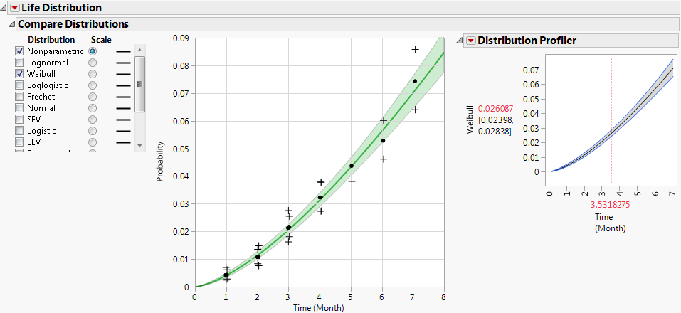

7. Click the Life Distribution disclosure icon.
JMP fits production and failure data with a Weibull distribution using the Life Distribution platform (Figure 9.3). JMP then uses the fitted Weibull distribution to forecast returns for the next five months (Figure 9.4).

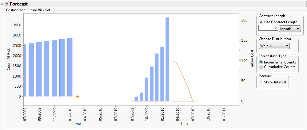

The Forecast report shows previous production in the left graph (Figure 9.4). In the right graph, you see that the number of previous failures increased steadily over time.
Figure 9.4 Forecast Report

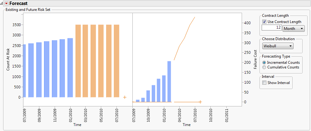

8. In the Forecast report, type 12 for the Contract Length.
9. In the left Forecast graph, drag the animated hotspot over to July 2010 and upward to approximately 3500.
Orange bars appear in the left graph to represent future production. The monthly returned failures in the right graph increase gradually through August 2010.

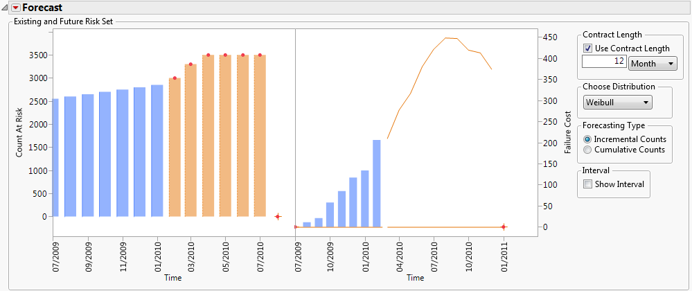

10. In the left graph, drag the February 2010 hotspot to approximately 3000 and then drag the March 2010 hotspot to approximately 3300.
11. In the right graph, drag the right hotspot to February 2011.
JMP estimates that the number of returns will gradually increase through August 2010 and decrease by February 2011.
