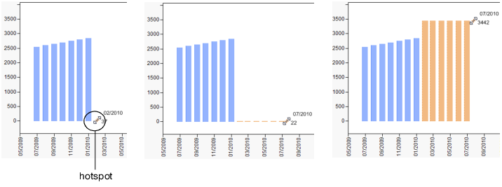

Future Production
In the left graph, the blue bars represent previous production counts. To add anticipated production, follow these steps:
1. Drag a hotspot to the right to add one or more production periods.
The orange bars represent future production.
Figure 9.11 Add Production Periods

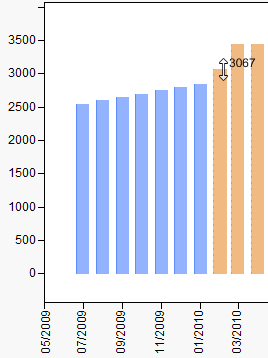

2. Drag each bar upward or downward to change the production count for each period.
Figure 9.12 Adjust Production Counts
Tip: To adjust future production counts, click the Forecast red triangle and select Spreadsheet Configuration of Risk Sets. See Spreadsheet Configuration of Risk Sets.

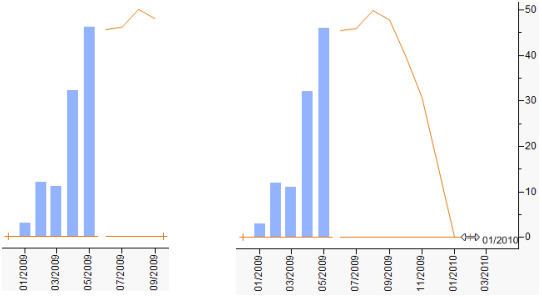

Forecasting Failures
When you adjust production in the left graph, the right graph is updated to estimate future failures (Figure 9.13). Dragging a hotspot lets you change the forecast period. The orange line then shortens or lengthens to show the estimated failure counts.
Figure 9.13 Adjust the Forecast Period
