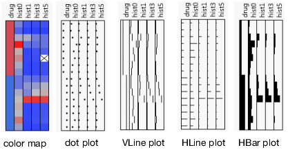

Graph Type
Use the Graph Type option to change the appearance of the graph.
Figure 8.5 Graph Types
