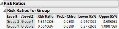

To show risk ratios for effects, select the Risk Ratios option from the red triangle menu. In this example, there is only one effect, and there are only two levels for that effect. The risk ratio for Group 2 is compared with Group 1 and appears in the Risk Ratios for Group report. See Figure 15.3. The risk ratio in this table is determined by computing the exponential of the parameter estimate for Group 2 and dividing it by the exponential of the parameter estimate for Group 1.

For this example, the risk ratio for Group2/Group1 is calculated as follows:
exp[-(-0.2979479)] /exp(-0.2979479) = 1.8146558
This risk ratio value suggests that the risk of death for Group 2 is 1.81 times that for Group 1.
Figure 15.3 Risk Ratios for Group Table
