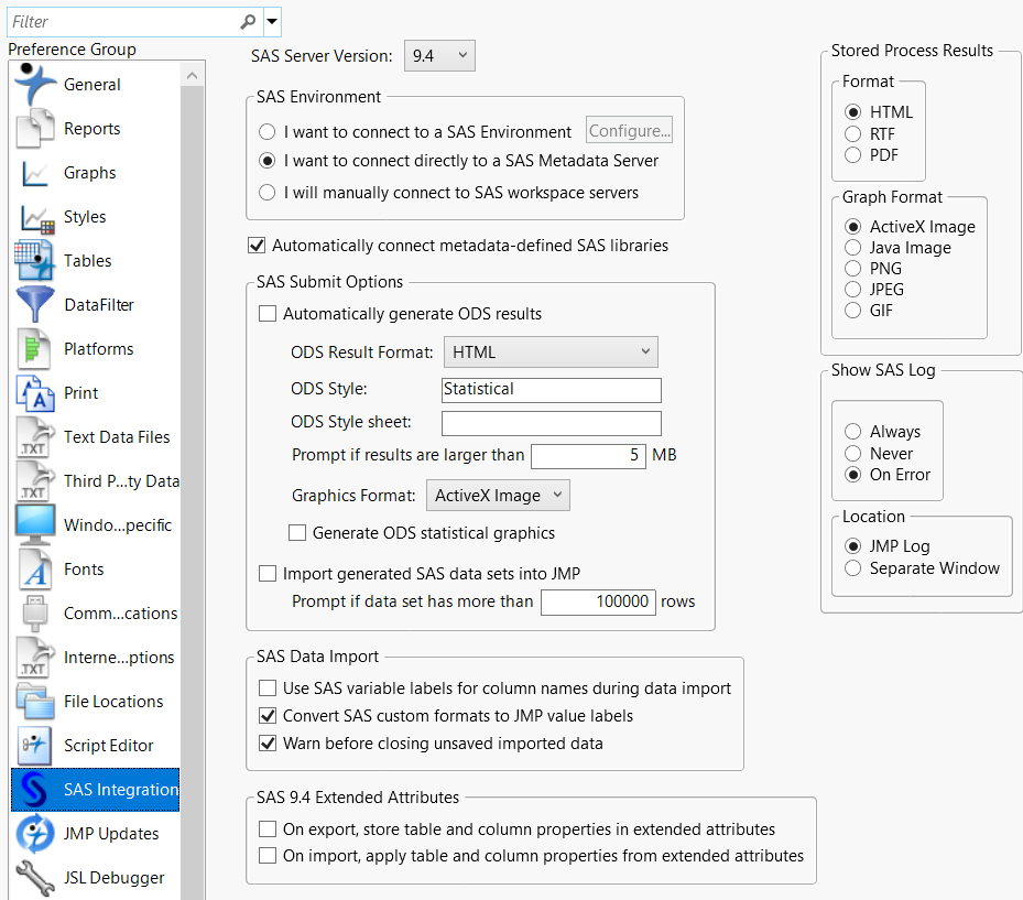

SAS Integration preferences customize the default settings for working with SAS servers. For more information about using the SAS Integration capabilities, see Import Data from SAS in the Import Your Data section.
Note: The SAS Environment options appear after you select SAS 9.3 or 9.4 from the SAS Server Version list.
Figure 13.18 SAS Integration Preferences
Preference | Description |
SAS Server Version | Select the default version for the SAS Server. This can also be changed in the Server Connections window. (See Connect to a SAS Metadata Server in the Import Your Data section.) This option does not apply when connecting to local SAS on Windows. |
I want to connect to a SAS Environment | Select this option to always connect to a SAS Environment and click Configure to configure the URL of the location. |
I want to connect to a SAS Metadata Server | Select this option to always connect to a SAS Metadata Server. This option is selected by default. Clear this option if you do not have a SAS Metadata Server available, and you connect directly to SAS Workspace Servers instead. |
I will manually connect to SAS workspace servers | Select this option to manually connect to a SAS workspace server. |
Automatically connect metadata-defined SAS libraries | Select this option to connect to metadata-defined SAS libraries automatically across all JMP sessions when you connect to a SAS Workspace Server. Selected by default. When the Workspace Server contains a large number of metadata-defined SAS libraries, deselect this option to speed up your connection to the server. |
Automatically generate ODS results | Select this option to generate output delivery system (ODS) results. This option is cleared by default. |
ODS Result Format | Select the format for ODS reports. The default value is HTML. |
ODS Style | Enter the style name for ODS reports. The default value is Statistical. |
ODS Style sheet | Enter the style sheet name for ODS reports. |
Prompt if results are larger than __ MB | Enter the number of MB that triggers a prompt for you to continue or cancel the operation. The default value is 5. |
Graphics Format | Select the format for graphics for ODS reports. |
Generate ODS statistical graphics | Select this option to include statistical graphics in the ODS reports. |
Import generated SAS data sets into JMP | Select this option to import any generated data sets into JMP automatically. |
Prompt if data set has more than __ rows | Enter the number of rows that triggers a prompt for you to continue or cancel the operation. The default value is 100,000. |
Use SAS variable labels for column names during data import | Select this option to use the column labels in the SAS data set as the JMP data table column names when importing a SAS data set into a JMP data table. |
Convert SAS custom formats to JMP value labels | Select this option to use the information in the SAS column formats to set JMP value labels when importing a SAS data set into a JMP data table. |
Warn before closing unsaved imported data | Select this option to trigger a prompt to save any SAS data sets that you imported into JMP and have not saved before closing. |
On export, store table and column properties in extended attributes | Select to allow extended attribute support during SAS 9.4 data export. This option is not selected by default. |
On import, apply table and column properties from extended attributes | Select to allow extended attribute support during SAS 9.4 data import. This option is not selected by default. |
Stored Process Results: Format | Select a report format: HTML, RTF, or PDF. |
Stored Process Results: Graph Format | Select a graph format: ActiveX Image (available only on a SAS server that runs on Windows), Java Image, PNG, JPEG, or GIF. |
Show SAS Log | Select Always, Never, or On Error to set when the SAS log is displayed |
Location | Select the location for SAS log information: within the JMP log window, or in a separate SAS log window. |
