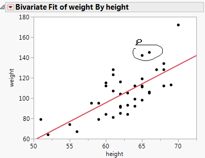

1. Click the lasso tool in the toolbar.
2. Click and hold the pointer (now lasso-shaped) in a plot.
Note: To keep all points selected as you drag the lasso around several sets of points, press the Shift key before you click in the plot.
3. Drag the lasso around any set of points.
Figure 9.21 Using the Lasso Tool
4. Release the mouse. JMP automatically closes the lasso and highlights the points within the enclosed area.
