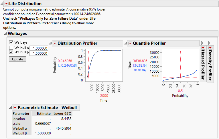

If you have data with zero failures (right-centered) and you have not turned off the preference Weibayes Only for Zero Failure Data, a special Weibayes report appears. Figure 3.10 shows the Weibayes report for the Weibayes No Failures.jmp sample data table, found in the Reliability folder.
Figure 3.10 Weibayes Report
The analysis begins by assuming an exponential model. The note at the top of the report provides a lower confidence bound for the parameter of an exponential distribution. This lower confidence bound is computed using the method described in Meeker and Escobar (1998, sec. 7.7).
The Weibayes section of the report conducts the Weibayes analysis. For a description of the procedure, see Nelson (1985).
To obtain Weibayes estimates, make sure that Weibayes and Weibull β options are selected. Change the Weibull β value and click Update. The estimates and profilers are updated. The values shown in the profilers use the conservative confidence bound. For an example, see Weibayes Example for Data with No Failures.
Note: If you deselect the Weibayes option, JMP shows the fixed parameter MLE.
