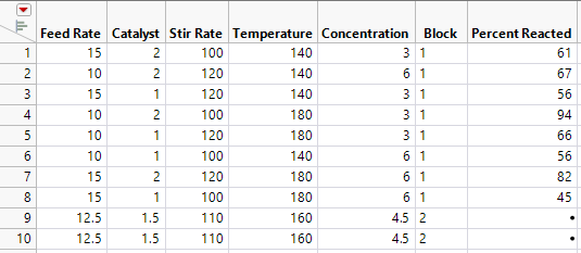

6. Select Group new runs into separate block to add a blocking variable to the design.
7. Click Add Centerpoints, enter 2, and then click OK.
8. Click Make Table.
Figure 6.15 Design with Two Center Points Added
