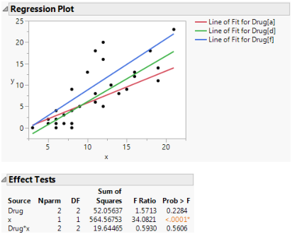

A portion of the report is shown in Figure 4.6. The Regression Plot shows fitted lines with different slopes. The Effect Tests report gives a p-value for the interaction of 0.56. This is not significant, indicating the model does not need to include different slopes.
Figure 4.6 Plot with Interaction

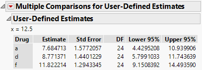

The User-Defined Estimates report shows least square means estimates for each level of Drug with the covariate x set to 12.5. The red triangle next to Multiple Comparisons for User-Defined Estimates contains options that enable you to test for differences among the estimates.
Figure 4.7 User-Defined Estimates Report

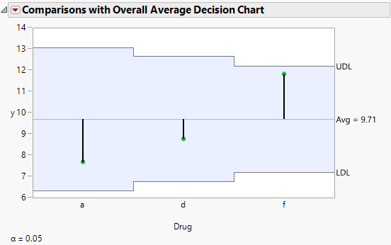

7. Click the red triangle next to Multiple Comparisons for User-Defined Estimates and select Comparisons with Overall Average.
Figure 4.8 Comparisons with Overall Average Decision Chart
The Comparisons with Overall Average option creates an analysis of means (ANOM) chart for differences between the average and the three least squares means. From the ANOM chart, you conclude that there is not a significant effect of Drug on the response at x = 12.5.
