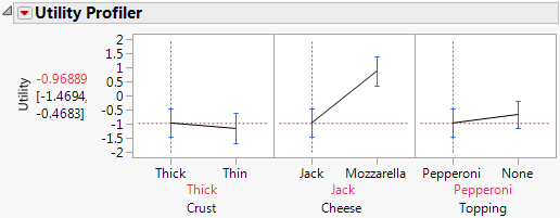

Figure 4.1 Choice Platform Utility Profiler
