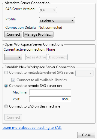

To begin, select File > SAS > Server Connections. The SAS Server Connections window shown in Figure 3.51 appears. All connections are made in this window.
Figure 3.51 SAS Server Connections
The following sections describe how to connect to a SAS server.

To connect to a Metadata Server
1. Select File > SAS > Server Connections. The SAS Server Connections window shown in Figure 3.51 appears.
2. Select the version for the SAS Server. Your SAS Metadata Server administrator should have this information.
SAS Server version 9.4 is selected by default based on the JMP SAS Integration preferences.
3. Select the profile that you want to use.
If you do not have a profile set up, see To create or modify a SAS Metadata Server profile.
4. Click Connect.
If JMP is unable to establish a connection, an error message appears. Common reasons are invalid user names or passwords. If you need to update the information for the profile, see To create or modify a SAS Metadata Server profile.
5. Click Close.

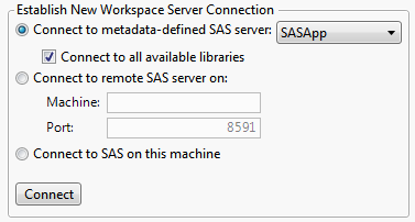

To connect to a SAS Workspace Server (Windows only)
2. Select the Workspace Server to connect to.
Figure 3.52 Open a Connection to a Workspace Server
3. Click Connect.
Under Open Workspace Server Connections, the Workspace Server is shown as the current active connection.
Figure 3.53 Current Active Connection
4. Click Close.

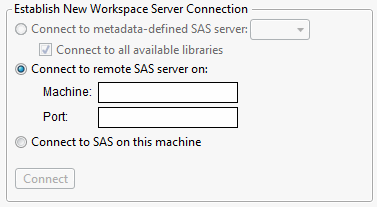

To connect to a Remote SAS Workspace Server
2. Under Establish New Workspace Server Connection, select Connect to remote SAS server on.
Figure 3.55 Open a Connection to a Remote SAS Server
3. Enter the machine name and the port number. Your SAS server administrator has this information.
4. Click Connect.
5. Enter your user name and password in the window that appears.
6. Click OK.
7. Click Close in the SAS Server Connections window.
