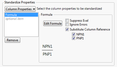

6. Select the three new columns and then select Cols > Standardize Attributes.
7. In the Standardize Properties section, select Formula from the list.
8. Select Substitute Column Reference and leave NPN1 and PNP1 selected.
Figure 7.12 Standardize Properties Options
Note: In this example, we want to change both NPN1 and PNP1. You can deselect the column that you do not want to change in the subsequent formulas.
9. Click OK.
A formula that is relative to the formula in the first new column is copied to the second and third selected columns.
