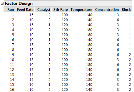

6. Select Group new runs into separate block to add a blocking variable to the design.
7. Click Fold Over and then click OK.
In the fold over dialog box, if you select no factors, then all design factors are included in the fold over. If you choose a subset of factors to fold over, the remaining factors are replicates of the original runs.
Figure 6.16 Foldover Design on All Factors
8. Click Make Table.
Each run in Block 2 can be obtained by changing the factor levels (from low to high or from high to low) of a run from Block 1.
