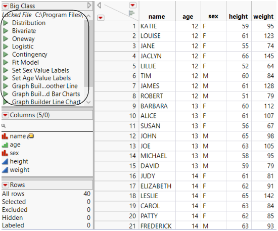

To automatically complete various analyses and tasks, you can create a JSL script and save it to the data table (Figure 4.62). For more information about writing data table scripts, see Table Scripts in the Scripting Guide.
Figure 4.62 Scripts Saved With the Data Table

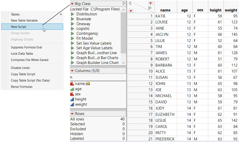

1. Click the red triangle to the left of the data table name in the Table panel.
Figure 4.63 Creating a Script
Creating a Script
2. Select New Script.
3. Give the script a name by typing it into the box beside Name.
4. Add the script by entering JSL code into the box beside Script.
