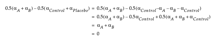

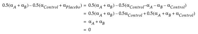

• Compare treatments A and B to the control and placebo groups:
Equation shown here
To obtain contrast coefficients for this contrast, you need to write the placebo effect in terms of the model effects. Specifically, use the fact that Equation shown here. Then Equation shown here. It follows that:
Equation shown here
