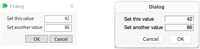

In New Window(), use Line Up Box() to arrange items in the number of columns that you specify. In the deprecated Dialog(), you used Line Up.
The following example arranges the text boxes in one column and the number edit boxes in another column:
win = New Window( "Line Up Box",
<<Modal,
<<Return Result,
V List Box(
Lineup Box( N Col( 2 ),
Text Box( "Set this value" ),
var1 = Number Edit Box( 42 ),
Text Box( "Set another value" ),
var2 = Number Edit Box( 86 ),
H List Box( Button Box( "OK" ), Button Box( "Cancel" ) ) )
Clicking OK returns the following result in the log window:
List( 3 elements ) assigned.
Figure 11.39 Default Dialog Arrangements for Windows (left) and macOS (right)
Here’s the same window created with the deprecated Dialog() and Line Up:
dlg = Dialog(V List(
Line Up( 2,"Set this value", variable = Edit Number( 42 ),
"Set another value", var2 = Edit Number( 86 )
H List( Button( "OK" ), Button( "Cancel" ) )
{variable = 42, var2 = 86, Button(1)}
Note: JMP does exert some control over OK and Cancel button positions to ensure that dialog boxes are consistent with what the operating system expects. In certain cases, JMP needs to override your H List Box(), V List Box(), and Line Up Box() settings for Button( "OK" ) and Button( "Cancel" ). Do not be alarmed if the result is slightly different from what you expect.
