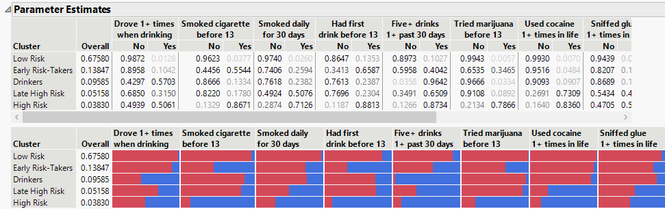

5. In the Latent Class Model for 5 Clusters report, examine the bar charts under Parameter Estimates. Note the following:
– Cluster 1 has mostly No answers to all of the risk behaviors.
– Cluster 2 has high numbers of Yes answers for the four risk behaviors before the age of 13.
– Cluster 3 has high numbers of Yes answers for driving when drinking and five or more drinks in the past 30 days.
– Cluster 4 has high numbers of Yes answers for most of the risk behaviors except for the ones before the age of 13.
– Cluster 5 has the highest number of Yes answers for most of the risk behaviors.
Use this information to give the clusters meaningful names.

Figure 15.3 Partial Parameter Estimates Report
Figure 15.3 shows parameter estimates for the first eight variables in the analysis. The new cluster names appear in the report window.

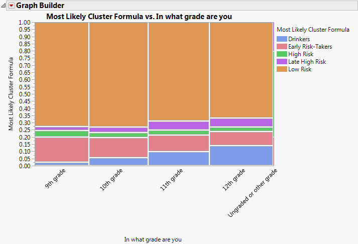

Next, compare cluster membership to the demographic question “In what grade are you”.
9. Click the red triangle next to Latent Class Model for 5 Clusters and select Save Mixture and Cluster Formulas.
10. Select Graph > Graph Builder.
11. Enter In what grade are you as X.
12. Enter Most Likely Cluster Formula as Y.
13. Select the Mosaic element.
14. Click Done.
Figure 15.4 Mosaic Plot of Cluster Membership versus Grade Level
Observe that most of the respondents fall into the Low Risk cluster. The class labeled Drinkers includes more respondents as the grade level increases.
