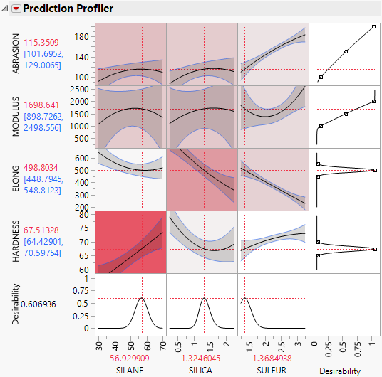

4. Click the red triangle next to Variable Importance: Independent Uniform Inputs and select Colorize Profiler.
Colors from a red to white intensity scale are overlaid on profiler panels to reflect Total Effect importance. For example, you easily see that the most important effect is that of Silane on Hardness.
Figure 3.29 Prediction Profiler for Four Responses
