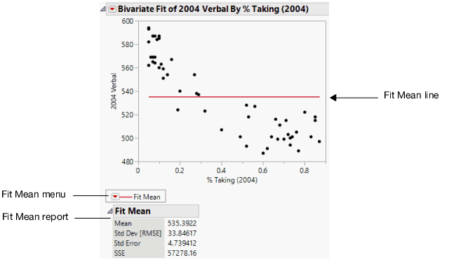

Figure 5.5 Example of the Fit Mean Option
The following fitting options are available:
Fit Mean
Adds a horizontal line to the scatterplot that represents the mean of the Y response variable. See Fit Mean.
