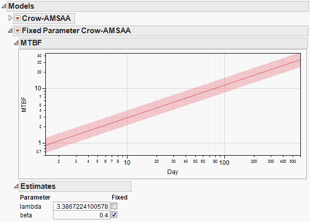

The initial parameter estimates are the MLEs from the Crow-ASMAA fit. Either parameter can be fixed by checking the box next to the desired parameter and then entering the desired value. The model is re-estimated and the MTBF plot updates to describe this model. Figure 10.16 shows a fixed-parameter Crow-AMSAA fit to the data in TurbineEngineDesign1.jmp, with the value of beta set at 0.4.
Figure 10.16 Fixed Parameter Crow-AMSAA ReportĀ
