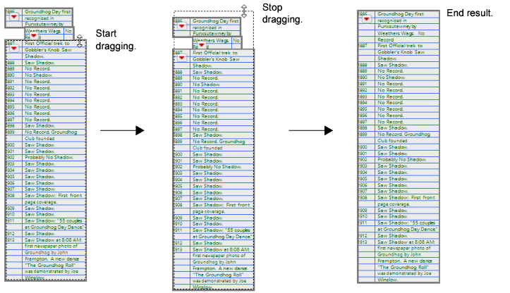

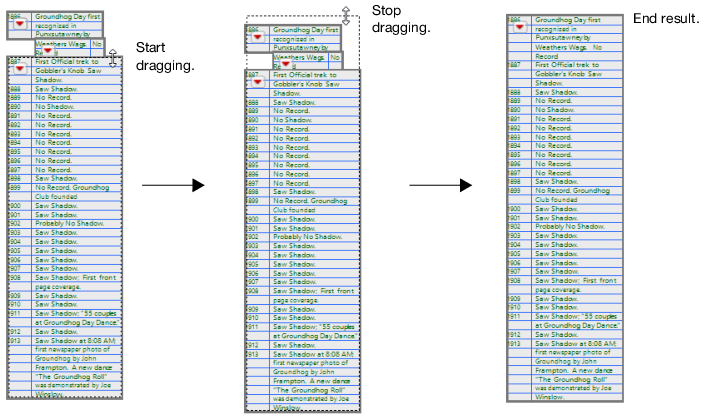

Notice that rows in the first column were auto-detected as three tables.
Drag the top edge of the third table up until it surrounds the two columns.
Figure 3.26 Creating One Table
Creating One Table

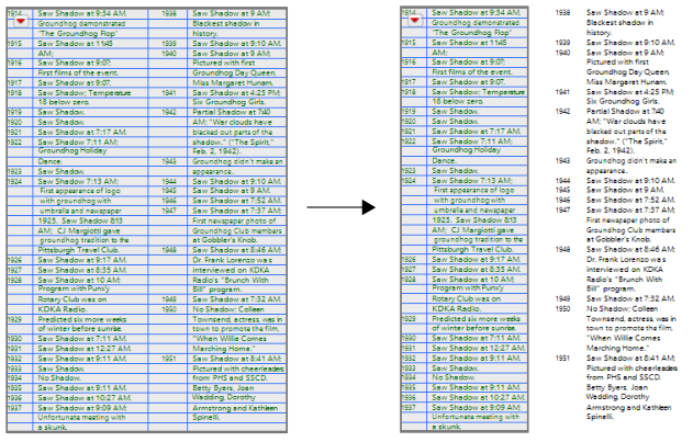

In the first table shown in Figure 3.27, drag the far right border to the left until only columns one and two are in the same table,and columns 3 and 4 are outside the table (Figure 3.27).
Figure 3.27 Splitting Up a Table
Drag a box around the remaining two columns to put them in a table (Figure 3.28).
Figure 3.28 Final Tables on Page One
