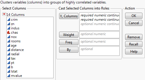

Launch the Cluster Variables platform by selecting Analyze > Clustering > Cluster Variables.
Figure 16.3 Cluster Variables Launch DialogĀ
Y, Columns
The variables to be clustered. Variables must be numeric and continuous.
Weight
A column whose numeric values assign a weight to each row in the analysis.
Freq
A column whose numeric values assign a frequency to each row in the analysis.
By
A column whose levels define separate analyses. For each level of the specified column, the corresponding rows are analyzed. The results are presented in separate reports. If more than one By variable is assigned, a separate analysis is produced for each possible combination of the levels of the By variables.
