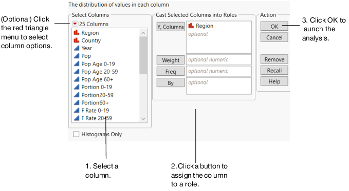

The launch window is your point of entry into a platform, where you specify the columns to analyze. Figure 2.11 shows the Distribution launch window.
Figure 2.11 Launch Window Features
All launch windows have in common provide the following options:

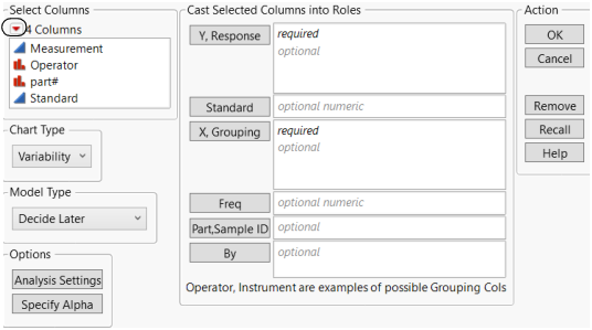

Select Columns
Lists all of the variables in your current data table. Note the following:
– Right-click the modeling type icon next to a column name to change the modeling type.
– Right-click the column name to create a transform column. See Transform Columns in a JMP Platform.
– Filter and sort the columns using the options in the red triangle menu. See Column Filter Menu.
Cast Selected Columns into Roles
Moves selected columns into roles (such as Y, X, and so on.) You cast a column into the role of a variable (like an actor is cast into a role). See Cast Selected Columns into Roles Buttons.

Action
The following options are available:
OK
Performs the analysis.
Cancel
Stops the analysis and quits the launch window.
Remove
Deletes any selected variables from a role.
Recall
Populates the launch window with the last analysis that you performed.
Help
Takes you to the Help for the launch window.
Tip: To reopen the platform launch window that was last opened, select View > Recall Last Platform (Windows) or Window > Recall Last Platform (macOS).

Column Filter Menu
A Column Filter menu appears in most of the launch windows. The Column Filter menu is found by clicking the red triangle in the Select Columns panel. Use these options to sort columns, show or hide columns, or search columns.
Figure 2.12 The Column Filter Menu
Reset
Resets the columns to its original list.
Show Filter
Opens a box in which you type the column name that you want to find. Click the arrow next to the box and select options to customize the filter.
