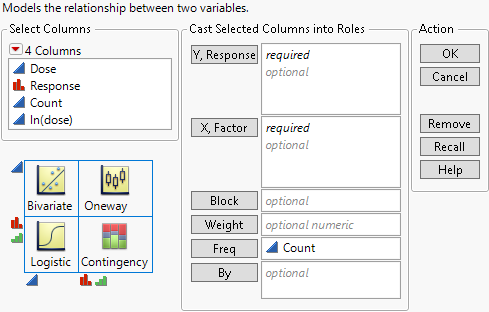

Launch the Fit Y by X platform by selecting Analyze > Fit Y by X.
Figure 4.2 The Fit Y by X Launch Window
Bivariate, Oneway, Logistic, Contingency
This grid shows which analysis results from the different combinations of data types. Once you have assigned your columns, the applicable platform appears as a label above the grid.
Block
(Optional. Applicable only for Oneway and Contingency.):
– For the Oneway platform, specifying a Block variable identifies a second factor, which forms a two-way analysis without interaction. In the Oneway plot, the values of the Y variable are centered by the Block variable. If there are equal counts in each block by group cell, the available Oneway platform options are adapted to the two-way analysis setting. If there are unequal counts in the block by group cells, a Fit Model report is shown below the Oneway plot and the Oneway platform options are not available.
– For the Contingency platform, specifying a Block variable identifies a second factor and performs a Cochran-Mantel-Haenszel test.
