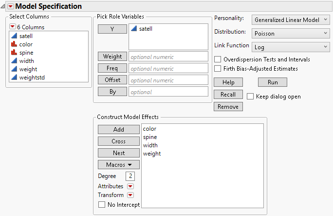

Launch the Generalized Linear Model personality by selecting Analyze > Fit Model, entering one or more columns for Y, and selecting Generalized Linear Model from the Personality menu.
Figure 12.4 Fit Model Launch Window with Generalized Linear Model Selected
