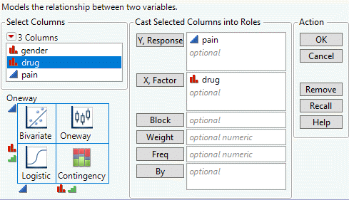

To perform a one-way analysis of variance, do the following:
1. Select Analyze > Fit Y by X.
2. Enter a continuous column for Y, Response.
3. Enter a nominal or ordinal column for X, Factor.
Figure 6.4 The Fit Y by X Launch Window
The word Oneway appears above the diagram, to indicate that you are performing a one-way analysis.
Note: You can also launch a one-way analysis from the JMP Starter window. Select View > JMP Starter > Basic > Oneway.
For more information about this launch window, see Introduction to Fit Y by X. For more information about the options in the Select Columns red triangle menu, see Column Filter Menu in Using JMP.
