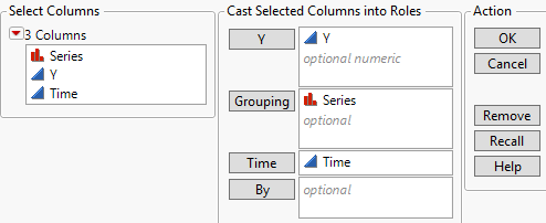

Launch the Time Series Forecast platform by selection Analyze > Specialized Modeling > Time Series Forecast.
Figure 19.4 The Time Series Forecast Launch Window
The Time Series Forecast platform launch window contains the following options:
Y
Assigns one or more columns as time series variables. Multiple time series can be organized as individual columns in a table or they can be stacked in a single column with one or more grouping variables.
Grouping
Assigns one or more columns as grouping variables. Grouping variables are used to identify individual time series when they are in stacked format.
Time
Assigns a column for the time variable. If the individual time series are organized as individual columns, the timestamps in the Time column must not contain any duplicates.
By
Assigns a column that creates a report consisting of separate analyses for each level of the variable. If more than one By variable is assigned, a separate analysis is produced for each possible combination of the levels of the By variables.
