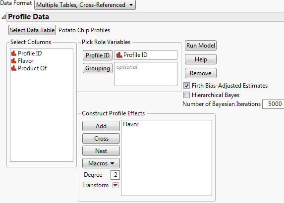

5. Click Select Data Table under Profile Data.
A Profile Data Table window appears, which prompts you to specify the data table for the profile data.
6. Select Potato Chip Profiles and click OK.
The columns from this table appear in the Select Columns.
7. Select Profile ID from the Select Columns list and click Profile ID under Pick Role Variables.
8. Select Flavor and click Add under Construct Model Effects.
Note that Product Of is another profile effect that you could add to the effects list.
Figure 5.5 Complete Profile Data Outline

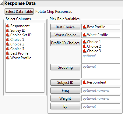

9. Open the Response Data outline. Click Select Data Table.
10. Select Potato Chip Responses and click OK.
11. Assign roles to columns to complete the launch dialog:
– Select Best Profile and click Best Choice.
– Select Worst Profile and click Worst Choice.
– Select Choice 1, Choice 2, and Choice 3 and click Profile ID Choices.
– Select Respondent and click Subject ID.
Figure 5.6 Completed Response Data Outline

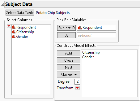

12. Open the Subject Data outline. Click Select Data Table.
13. Select Potato Chip Subjects and click OK.
14. Select Respondent and click Subject ID.
15. Select Citizenship and Gender and click Add under Construct Model Effects.
Figure 5.7 Completed Subject Data Outline

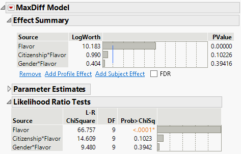

Explore the Model
1. Click Run Model.
Figure 5.8 MaxDiff Model Report
The Effect Summary report shows the terms in the model and gives p-values for their significance. Notice that Flavor is a profile effect, and that each of Citizenship*Flavor and Gender*Flavor is an interaction of a subject and a profile effect.
The Likelihood Ratio Tests report indicates that Flavor is significant.
