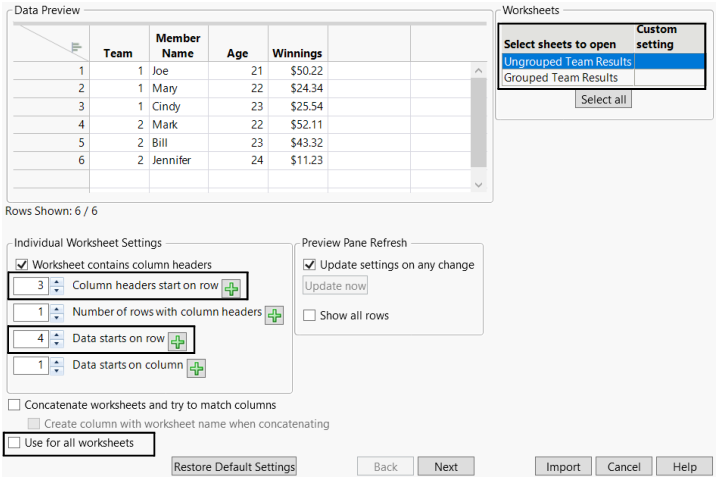

5. Type 3 for Column headers start on row
6. Data starts on row changes to 4.
7. Select Ungrouped Team Results in the Worksheets pane.
Only this worksheet will be imported.
8. Deselect Use for all worksheets.
These settings apply only to Ungrouped Team Results.

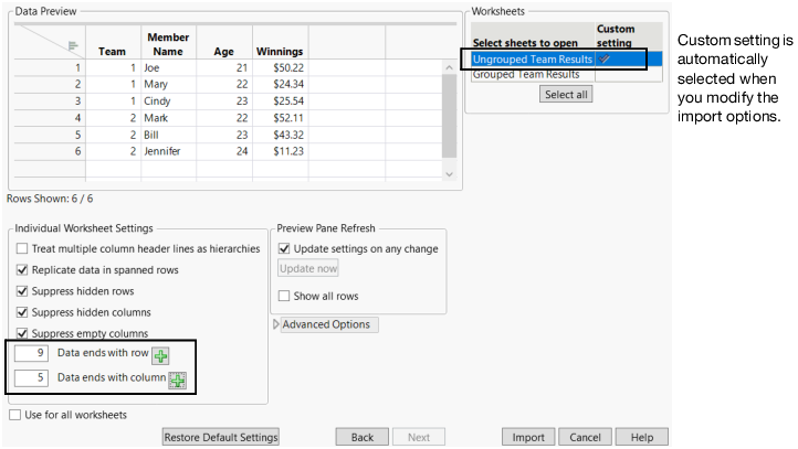

10. For Data ends with row, type 9.
11. For Data ends with column, type 5.

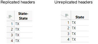

Replicate headers in spanned rows
Repeats the header text in each cell for rows that are spanned in the worksheet. For example, the State column heading shown in Figure 3.7 was in a merged cell in the worksheet. On the left, the heading is replicated. Deselect the option to avoid repeating the heading as shown on the right.

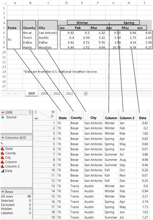

In an Excel worksheet, multiple header rows can have an implied hierarchy; the second header row contains data that are categories of the first header row. Figure 3.8 shows an example. In the worksheet at the top, the seasons “Winter” and “Spring” are in spanned cells above the months within those seasons. In the JMP data table, you want the seasons in one column and their corresponding months in another column.
Figure 3.8 The Original Data in Excel and Final Data in JMP for 2009

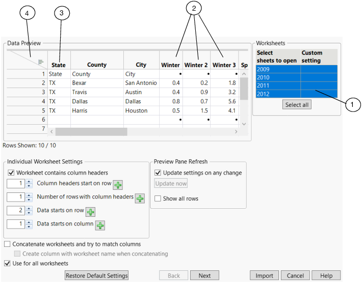

Figure 3.9 Excel Import Wizard Preview
Figure 3.9 shows the default settings for this worksheet:
1
All worksheets are selected for import. Press Ctrl and click a worksheet to exclude it from the import.
2
Each season is split over several columns.
3
Data from the second heading row of the worksheet appear in the first row.
4
The empty rows at the top have been removed.

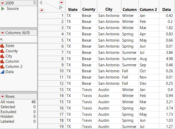

The four worksheets open as separate data tables. The data tables contain a Source script, which you can run to import the data into new data tables using the same import settings (Figure 3.12). Your import settings are also saved the next time you open the worksheet in the Excel Wizard in any JMP session.
Figure 3.12 The Final Data
