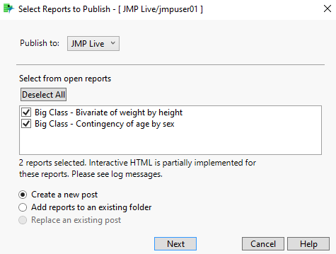

Figure 10.4 Select Reports Window
4. (JMP Live only) Next to Publish to, select a JMP Live server.
5. Select the open reports that you want to publish.
6. Choose your action and then click Next:
– Create a New Post
– Add Reports to an Existing Folder
– Replace an Existing Report in a Post (if a post with the exact name exists)

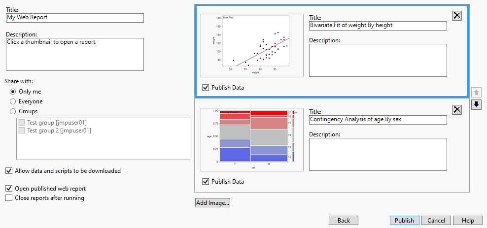

1. (Multiple posts only) Enter a title for the folder and an optional description.
2. (Optional) Update the title for each report and add descriptions.
3. Choose how to share the post:
– Only Me keeps your post private and visible to you only.
– Everyone shares your post with everyone on JMP Public or JMP Live.
– Groups shares your post with groups that you select. Groups that you can publish to appear below this option.
4. Change additional options. See Post Options.
5. Click Publish.
6. Click OK to dismiss the informative window.

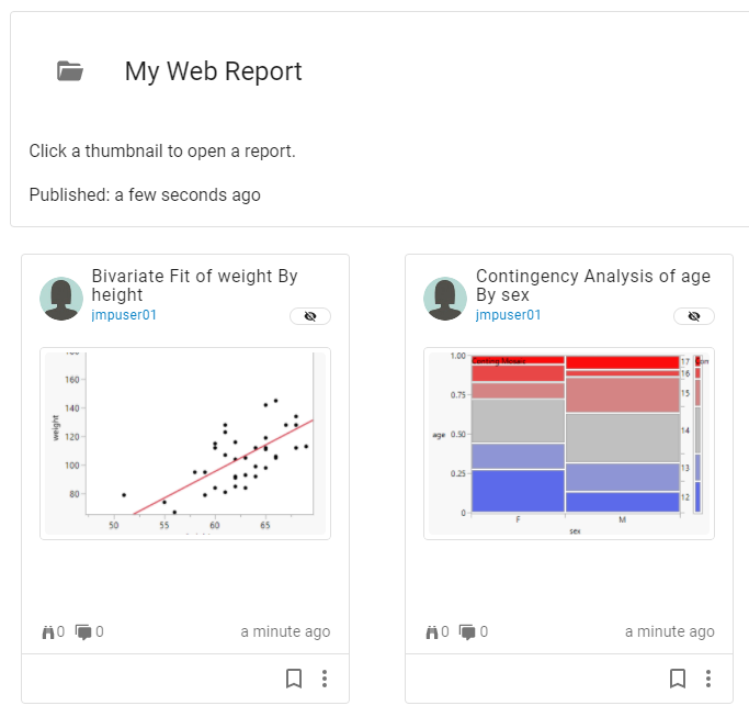

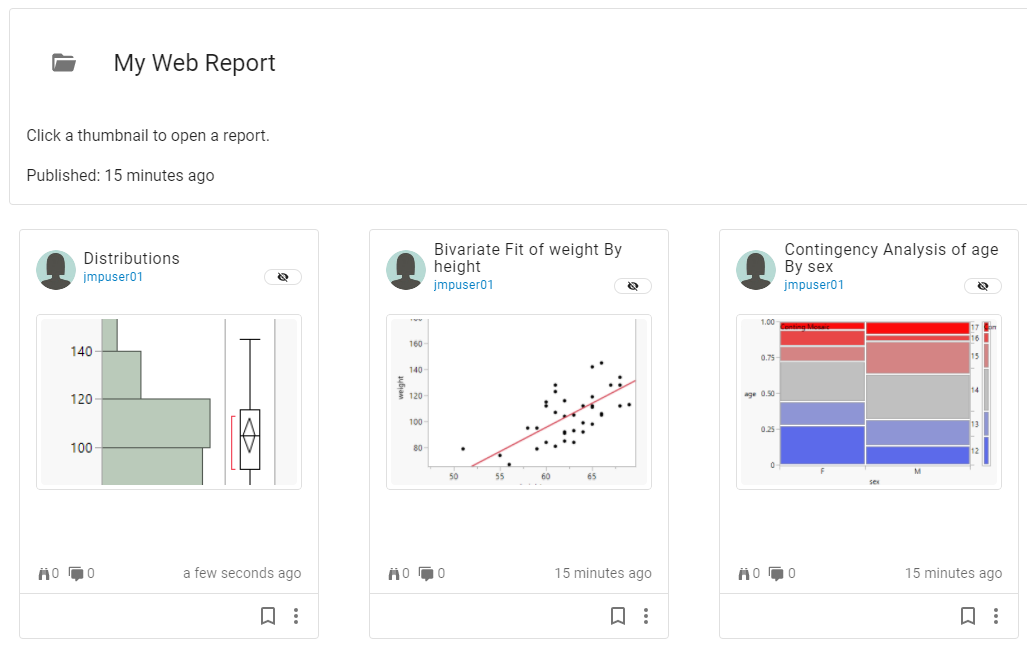

Figure 10.6 JMP Live Folder Containing Reports

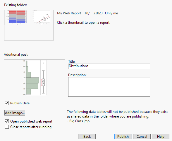

Figure 10.8 Add a Report to an Existing Folder
Note: If you are publishing multiple reports, the window and options in Figure 10.8 are slightly different.
3. Change additional options. See Post Options.
4. Click Publish.
5. Click OK to dismiss the informative window.

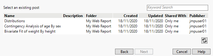

Figure 10.10 Select an Existing Post
Note: You see only posts that you have permission to update.
1. Select a post. Do one of the following:
– Click a post in the list and click Next.
– Search for a post—In the Keyword Search box, enter a word that appears in the post name or description and then click a post. Click Next.

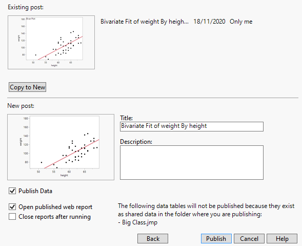

Figure 10.11 Replace an Existing Post
2. Choose one of the following options:
– To use the same title and description (if one exists) from the existing post, click Copy to New.
– To use an updated title and description, enter a new title and description.
4. Click Publish.
