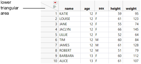

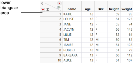

• Press Shift and click the lower triangular area in the upper left corner of the data grid to select. Click again in the same area to deselect all rows (Figure 4.7).
• To clear all highlighted areas in the data table, press Esc.
Figure 4.7 Lower Triangular Area
