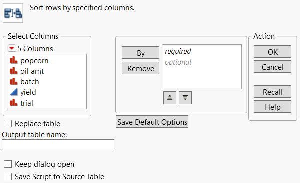

2. Select Tables > Sort.
Figure 6.5 The Sort Window
3. Highlight the names of the columns that you want to sort by. For this example, select popcorn and yield.
4. Click By to add the columns to the sort list.

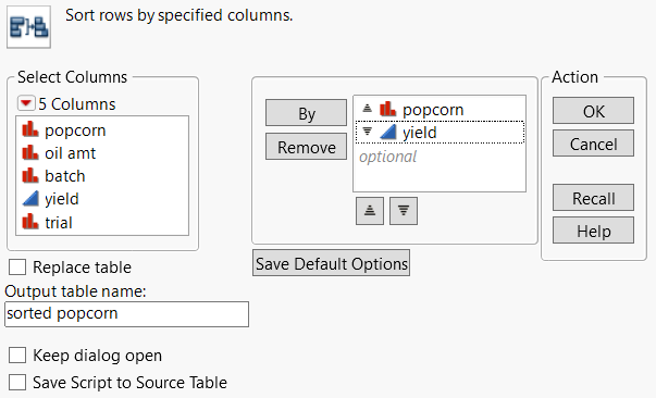

5. Customize your sort further using the additional options. For this example, highlight yield and click the descending button.![]()
6. Enter a name for the new sorted table in the box beside Output table name. For this example, enter sorted popcorn.
Figure 6.6 Completed Sort Window
7. Click OK.

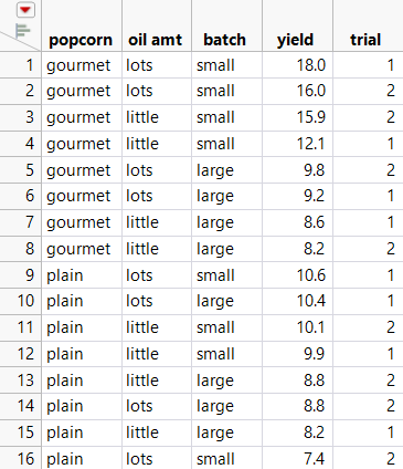

Figure 6.7 Sorted in Ascending and Descending Order
