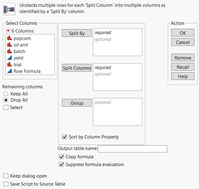

1. Select Tables > Split.
Figure 6.12 Split Window
Split Window
2. Highlight the names of the column or columns that you want to split and click Split Columns.
3. Highlight a column whose values you want to use as the basis for splitting the column.
4. Click Split By.
5. Customize your splitting further using the additional options.
6. Click OK.
