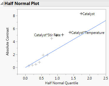

Figure 10.1 Half Normal Plot from Fit Two Level Screening Report
