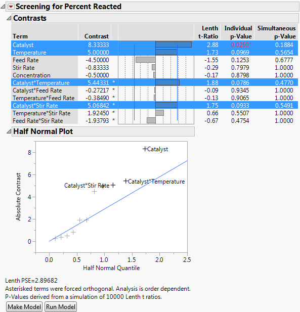

The Fit Two Level Screening report shows a summary table of the design contrasts (candidate model terms) and a half normal plot. You can launch or run the selected model from the report.
Figure 10.5 Screening Report
Screening Report
• Contrasts
• Half Normal Plot
• Make or Run Model
