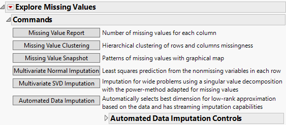

After you click OK in the launch window, the report opens to show a Commands outline and a Missing Columns report. The commands are the following:
• Missing Value Report
• Missing Value Clustering
• Missing Value Snapshot
• Multivariate Normal Imputation (Not available if you entered a Numeric column with a Nominal or Ordinal modeling type in the launch window.)
• Multivariate SVD Imputation (Not available if you entered a Numeric column with a Nominal or Ordinal modeling type in the launch window.)
• Image shown hereAutomated Data Imputation (Not available if you entered a Numeric column with a Nominal or Ordinal modeling type in the launch window.)
Tip: To run a missing value command across all levels of a By variable, press Ctrl and click the desired command button.

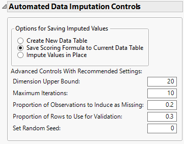

Automated Data Imputation Controls
The ADI utility contains options for saving the imputed values and advanced controls.
Figure 21.13 ADI Controls
ADI Controls
Options for Saving Imputed Values
The following three options for saving the imputed values for the ADI method are available:
Create New Data Table
Creates a new data table that has the same dimensions as the original data table. In the new data table, the columns selected in the launch window contain the imputed values.
Save Scoring Formula to Current Data Table
Saves a column group, named Imputed_, to the current data table that contains the imputed columns specified in the launch window. A hidden column, ADI Impute Column, is also added to the current data table that contains the imputed vectors and the scoring formula used in the data imputation. The column formulas automatically update if any additional rows are added to the data table, enabling missing data imputation for streaming data. This is the default option.
Impute Values in Place
Imputes the missing values in the current data table. The imputed values are displayed in light blue.
Advanced Controls
Contains the following advanced controls, which default to recommended settings based on the data:
Dimension Upper Bound
Determines the maximum rank allowed in the low-rank approximation. This is determined by the dimension of the matrix formed by the chosen columns.
Maximum Iterations
Determines the number of values that are iterated over to determine the tuning parameter for the imputation model. The default is 10.
Proportion of Observations to Induce as Missing
Determines the proportion of IM values that are added to the training and validation sets. The default proportion for each set is 0.2.
Proportion of Rows to Use for Validation
Determines the proportion of rows to use in the training and validation sets. The default proportion for the validation set is 0.3.
Set Random Seed
Determines the random seed for ADI. Use this option to obtain reproducible results.
