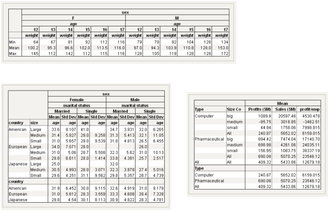

The Tabulate output consists of one or more column tables concatenated side by side, and one or more row tables concatenated top to bottom. The output might have only a column table or a row table.
Figure 9.10 Tabulate Output
Tabulate Output
Creating a table interactively is an iterative process:
• Click the items (columns or statistics) from the appropriate list, and drag them into the drop zone (for rows or columns). See Edit Tables, and Column and Row Tables.
• Add to the table by repeating the drag and drop process. The table updates to reflect the latest addition. If there are already column headings or row labels, you can decide where the addition goes relative to the existing items.

• When you drag and drop multiple columns into the initial table:
– If the columns share a set of common values, they are combined into a single table. A crosstabulation of the column names and the categories gathered from these columns is generated. Each cell is defined by one of the columns and one of the categories.
– If the columns do not share common values, they are put into separate tables.
– You can always change the default action by right-clicking on a column and selecting Combine Tables or Separate Tables. See Right-Click Menu for Columns.
• To nest columns, create a table with the first column, and then drag the additional columns into the first column.
