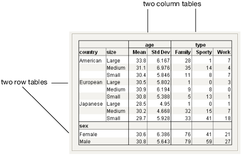

In the Tabulate platform, a table is defined by its column headings and row labels. These sub-tables are referred to as row tables and column tables (Figure 9.11).
Example of Row and Column Tables in the Tabulate Platform

Figure 9.11 Row and Column TablesĀ
For multiple column tables, the labels on the side are shared across the column tables. In this instance, country and sex are shared across the tables. Similarly, for multiple row tables, the headings on the top are shared among the row tables. In this instance, both age and type are shared among the tables.
