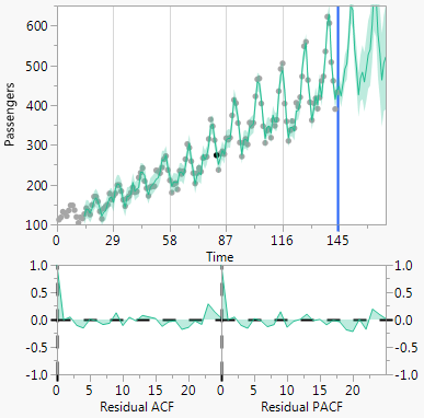

Figure 18.1 Forecast PlotĀ
Forecast Plot
