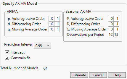

13. Set the range for all parameters from 0 to 1. The Specify ARIMA Model window looks like the one in Figure 18.22.
Figure 18.22 ARIMA Model Group Specifications
