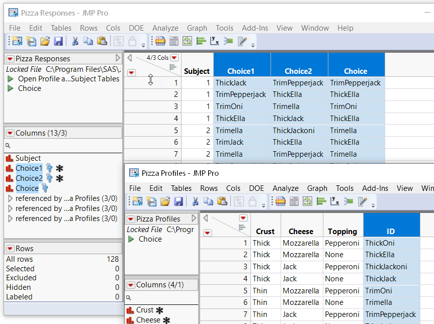

Figure 6.36 shows an example of virtually joined data tables. Pizza Profiles.jmp is the referenced data table because the ID column contains a Link ID column property. The ID column contains unique values that correspond to data in the referencing data table, Pizza Responses.jmp.
Figure 6.36 Virtually Joined Data Tables
Note: A column can have a Link Reference column property, but it does not necessarily have to link columns from the referenced data table. The virtual join icon next to the column in the Columns list is gray Image shown here. This can happen if the referenced data table is not opened or the referencing column is excluded. See Virtual Join Icons for more information about the other virtual join icons.
With the link column properties setup, all columns from the referenced data tables become part of your main data table. Therefore, if the main data table has a referencing column, the columns of the referenced table automatically appear in the Select Columns list of the launch window.
