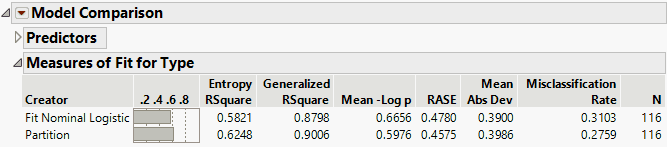

Figure 11.8 Initial Model Comparison Report
The report shows that the Partition model has slightly higher values for Entropy RSquare and Generalized RSquare and a slightly lower value for Misclassification Rate.

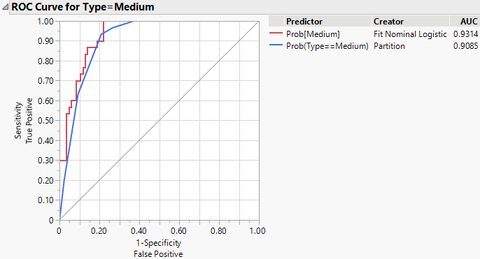

4. Click the Model Comparison red triangle and select ROC Curve.
ROC curves appear for each Type, one of which is shown in Figure 11.9.
Figure 11.9 ROC Curve for Medium
Examining all the ROC curves, you see that the two models are similar in their predictive ability.

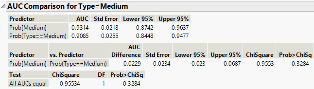

5. Click the Model Comparison red triangle and select AUC Comparison.
AUC Comparison reports appear for each Type, one of which is shown in Figure 11.10.
Figure 11.10 AUC Comparison for Medium
The report shows results for a hypothesis test for the difference between the AUC values (area under the ROC curve). Examining the results, you see there is no statistical difference between the values for any level of Type.
You conclude that there is no large difference between the predictive abilities of the two models for the following reasons:
• The R Square values and the ROC curves are similar.
• There is no statistically significant difference between AUC values.
