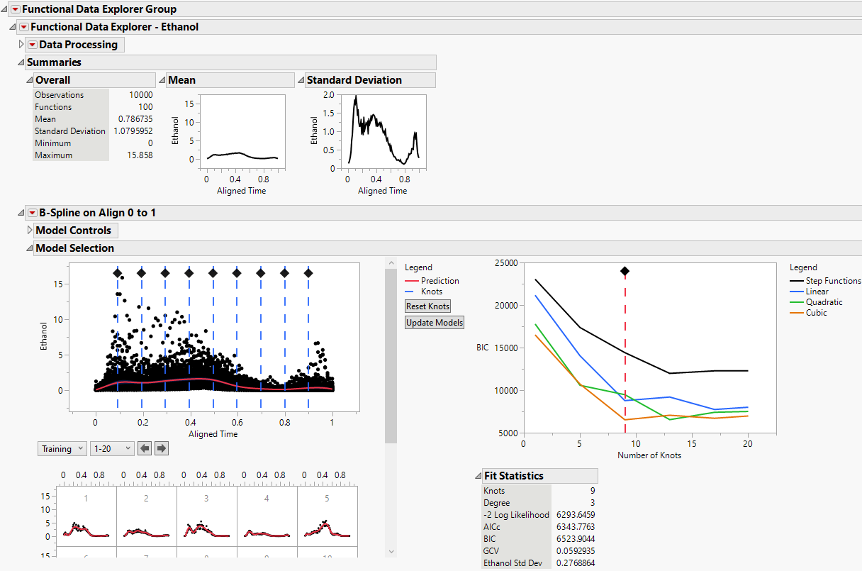

7. Click the Functional Data Explorer Group red triangle and select Data Processing > Align > Align 0 to 1. This aligns the input variable to be between 0 and 1 in each Functional Data Explorer report.
8. Click the Functional Data Explorer Group red triangle and select Models > B-Splines. This fits a B-spline model to each of the functional processes.
Figure 16.7 Functional Data Explorer Report for Ethanol
Figure 16.8 Model Summary Report for Ethanol
Figure 16.7 and Figure 16.8 show the model reports for one of the functional process variables, Ethanol. Scroll through the full report to view the models fit for each of the process variables. Next, use the FPCs in the Function Summaries report in an analysis.

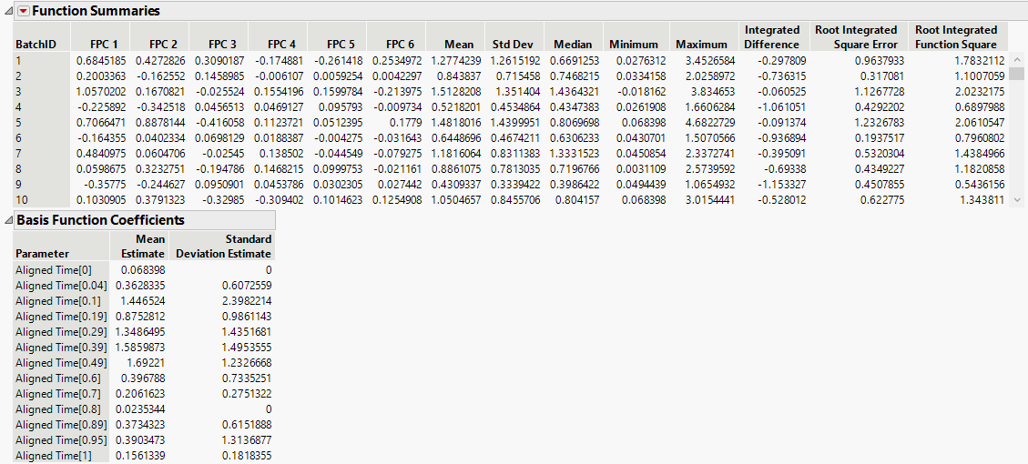

1. Press Ctrl, click any Function Summaries red triangle, and select Customize Function Summaries.
2. In the box next to Enter number of FPCs to show, type 3.
3. Click the Deselect All Summaries box.
4. Click OK.
5. Click the Functional Data Explorer Group red triangle and select Save Summaries.
6. Select Help > Sample Data Library and open Functional Data/Fermentation Process Batch Yield Results.jmp.
7. In the Functional Data Explorer Model Summaries.jmp data table, right-click BatchID and deselect Link ID.
8. In the Functional Data Explorer Model Summaries.jmp data table, right-click BatchID and select Link Reference > Fermentation Process Batch Yield Results.jmp.
This virtually joins the yield data table and the summaries data table.

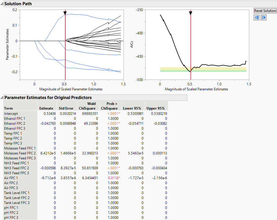

Fit a Generalized Regression Model
Use the Generalized Regression personality of the Fit Model platform to determine how Yield is affected by the functional process variables.
1. In the Functional Data Explorer Model Summaries.jmp data table, select Analyze > Fit Model.
2. Click the triangle next to referenced by BatchID to Fermentation Process Batch Yield Results.
3. Select Yield[BatchID] and click Y.
4. Select the remaining columns, except Time and BatchID, and click Add.
5. Change the Personality to Generalized Regression.
6. Click Run.
7. Select the Adaptive box.
8. Click Go.
Figure 16.9 Generalized Regression Report for Batch Yield
The Generalized Regression report shows that Yield is significantly affected by certain components of Ethanol, Molasses Feed, NH3 Feed, and Air. The RSquare for the model is 0.73225. By using FDE to perform dimension reduction on the functional processes first, you greatly reduce the number of variables, while still retaining the ability to build a reasonable prediction models.
