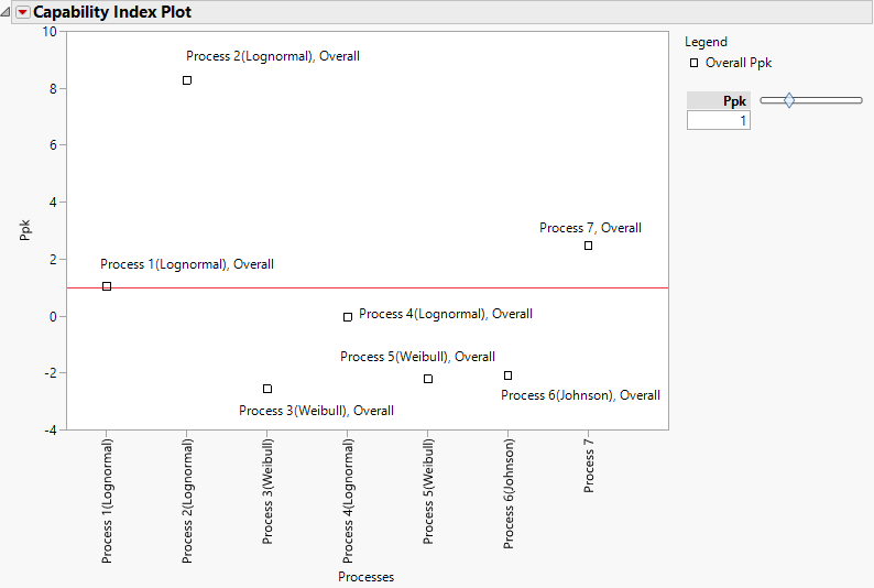

Figure 7.13 shows a Capability Index Plot report for the Process Measurements.jmp sample data table. Six of the variables are fit with nonnormal distributions. Process 7 is fit with a normal distribution. Points have been labeled using the Label Overall Sigma Points option that is available in the Capability Index Plot red triangle menu.
Figure 7.13 Capability Index Plot with Nonnormal Distributions
