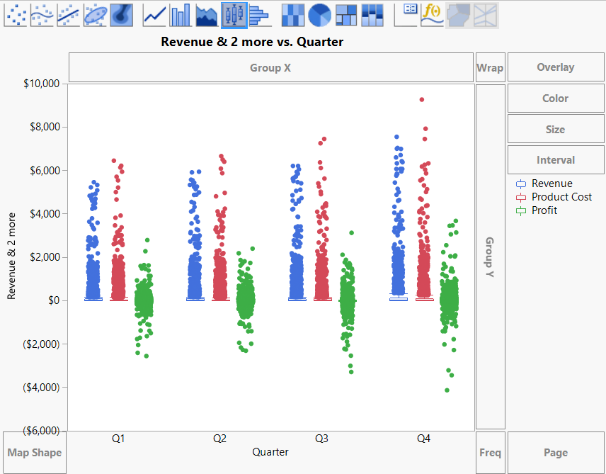

Based on the variables that you are using, Graph Builder shows side-by-side box plots.

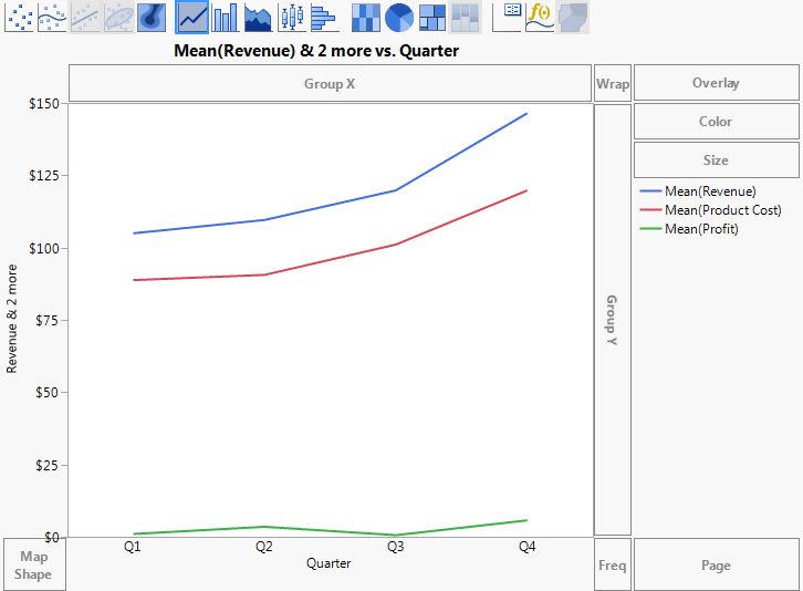

5. To change the box plots to a line plot, click the Line icon Image shown here.

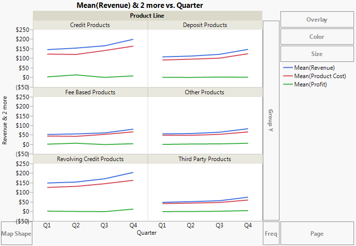

6. To create a separate chart for each product, click Product Line, and drag and drop it into the Wrap zone.
A separate line plot is created for each product.

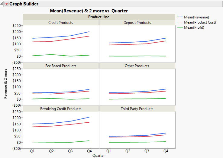

Figure 4.25 Final Line Plots
Final Line Plots

Figure 4.25 shows revenue, cost, and profit broken down by product line. The business analyst was interested in seeing the difference in profitability between product lines. The line plots in Figure 4.25 can provide some answers:
• Credit products, deposit products, and revolving credit products produce more revenue than fee-based products, third-party products, and other products.
• However, the profits of all the product lines are similar.

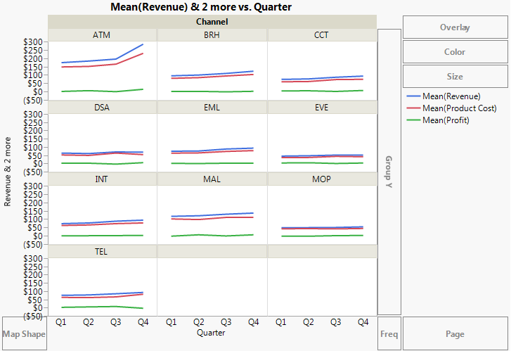

The data table also includes data on sales channels. The business analyst wants to see how revenue, product cost, and profit differ between different sales channels.
1. To remove Product Line from the graph, click the title of the graph (Product Line) and drag and drop it into any empty area within Graph Builder.
2. To add Channel as the wrap variable, click Channel and drag and drop it into the Wrap zone.
Figure 4.26 Line Plots Showing Sales Channels
Figure 4.26 provides this answer: revenue and product cost for ATMs are the highest and are growing the most quickly.
