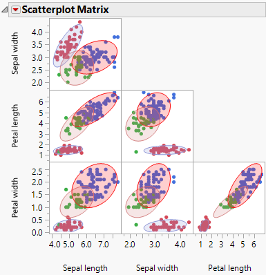

Figure 6.9 Example of a Scatterplot Matrix Using a Cluster Variable
