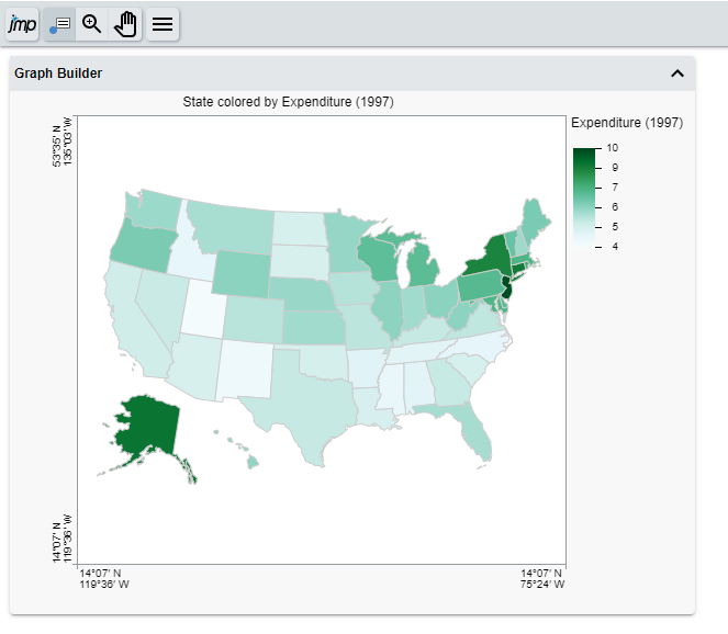

Figure 7.16 Web Page for Single Interactive HTML Report

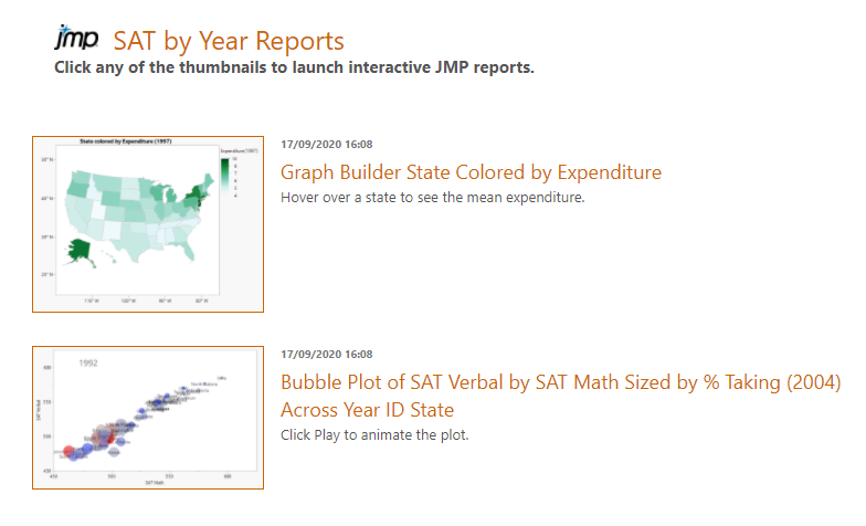

Figure 7.17 Index Page for Multiple Interactive HTML Reports
9. Click a thumbnail to open a report.
For details about working with interactive reports, from an HTML report, click Image shown here > Help. This opens the help at https://www.jmp.com/interactive.
