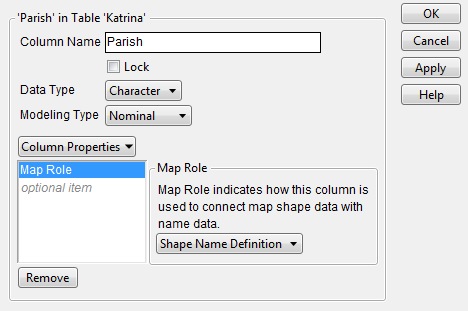

To add the Map Role property into the -Name data table:
1. Right-click the column containing the boundaries and select Column Properties > Map Role.
2. Select Shape Name Definition below Map Role.
3. Click OK.
4. Save the data table.
Figure 12.10 Shape Name Definition Example

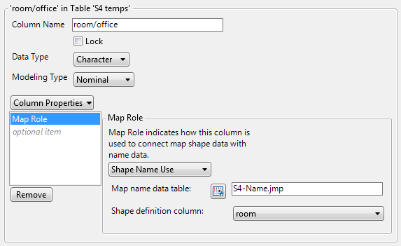

To add the Map Role property into the data table that you are analyzing:
Note: Perform these steps only if your custom boundary files do not reside in the default custom maps directory.
2. Select Shape Name Use below Map Role.
3. Next to Map name data table, click Image shown here to browse to a -Name map data table. You can enter the relative or absolute path.
If the map data table is in the same folder, enter only the filename. Quotation marks are not required when the path contains spaces.
4. From the Shape definition column list, select the column in the map data table whose values match those in the selected column.
Figure 12.11 shows an example of the room/office column in the S4 Temps.jmp sample data table.
Figure 12.11 Shape Definition Column Example
5. Click OK.
6. Save the data table.
