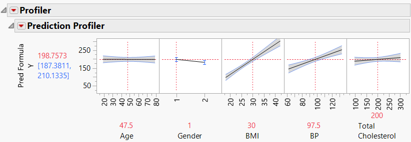

Launch the Profiler
The data table now contains two additional columns named Pred Formula Y and PredSE Y. Use these formula columns in the Profiler.
1. Select Graph > Profiler.
2. Select Pred Formula Y and PredSE Y and click Y, Prediction Formula.
3. Click OK.
A JMP Alert window appears asking if you want to use the PredSE column to make intervals for the Pred Formula Y column.
4. Click Yes in the JMP Alert window.
Figure 3.38 Profiler with Confidence Intervals
A prediction profiler with confidence intervals constructed using the standard error of the predicted values is shown.
