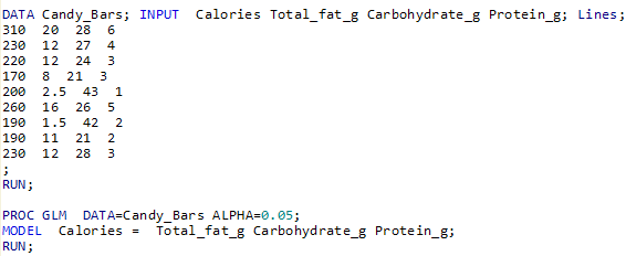

This example uses the Candy Bars.jmp sample data table, which contains nutrition data for candy bars.
1. Select Help > Sample Data Library and open Candy Bars.jmp.
3. Select Calories and click Y.
4. Select Total fat g, Carbohydrate g, and Protein g, and click Add.
5. Click the Model Specification red triangle and select Create SAS Job.
Figure 8.9 shows the SAS code. (Not all of the data is shown.)
Figure 8.9 SAS CodeĀ
SAS Code
